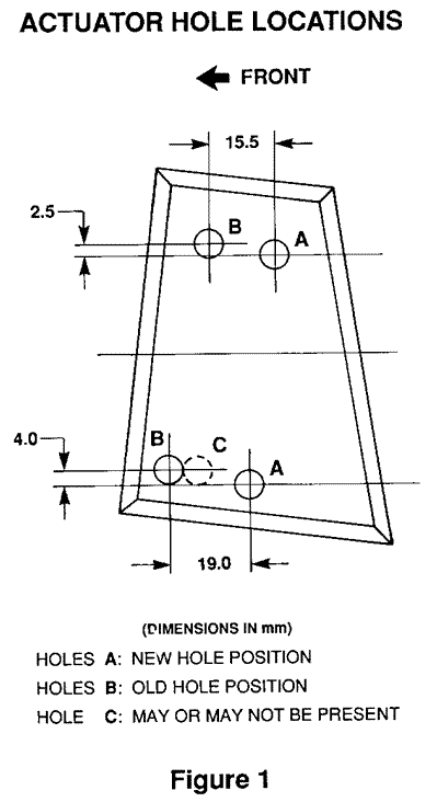

In addition to replacing the above components, it may be necessary to relocate the power door lock actuator on the door inner panel. Figure 1 will illustrate the hole patterns.
- If the actuator is located in the holes marked "A," it will not need to be relocated.
- If the actuator is located in the holes marked "B";
- remove the actuator by drilling out the attaching rivets.
- locate the new attaching holes ("A") using the dimensions on the illustration.
- attach the actuator in the new location using 1/4" X 1/2" peel type rivets.
IMPORTANT: Hole "C" may or may not be present. Relocate holes from "B" locations only.
