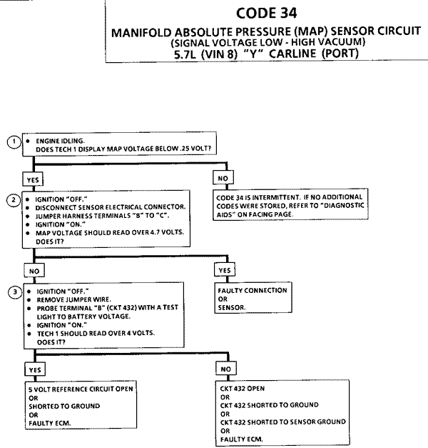

Subject: SERV MANUAL UPDATE-SEC.6E3 DRIVEABILITY AND EMISSIONS
Model and Year: 1990 CORVETTE WITH 5.7L L98 (VIN CODE 8) ENGINE
Source: Chevrolet Service Bulletin
Bulletin Number: 90-350-6E - (09/13/1990)
The attached Code 34 diagnostic chart replaces the diagnostic chart found in DRIVEABILITY AND EMISSIONS (SECTION 6E3) on page 6E3-A-47 of the 1990 "Y" 5.7L L98 (VIN 8) Corvette Service Manual.
