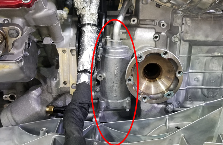

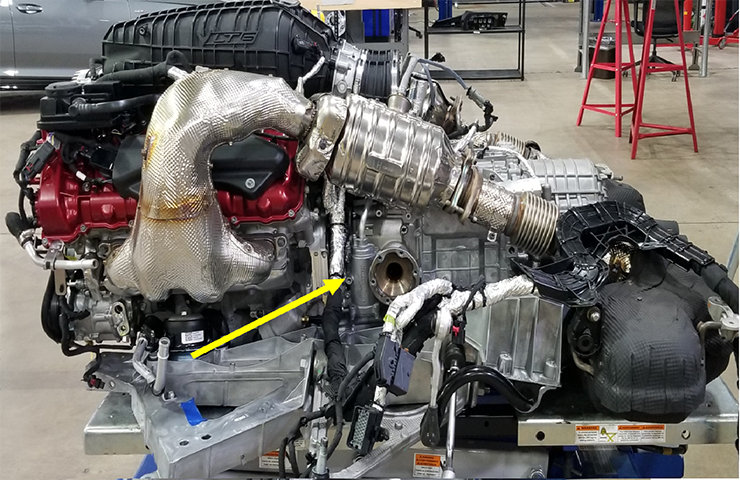

The canister filter (Fig. 5) should be replaced in the first 7,500 miles (12,000 km) due to the initial break-in of the internal transmission components. The 7,500-mile (12,000 km) break-in period is when most contaminants may be created. Engineering recommends that the filter be changed as close to 7,500 miles (12,000 km) as possible – plus/minus 1,000 miles (1,600 km) should not be detrimental.

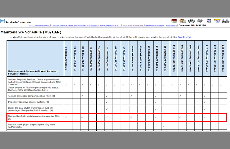

Check the maintenance schedule in the appropriate Service Information for complete maintenance information. (Fig. 7)

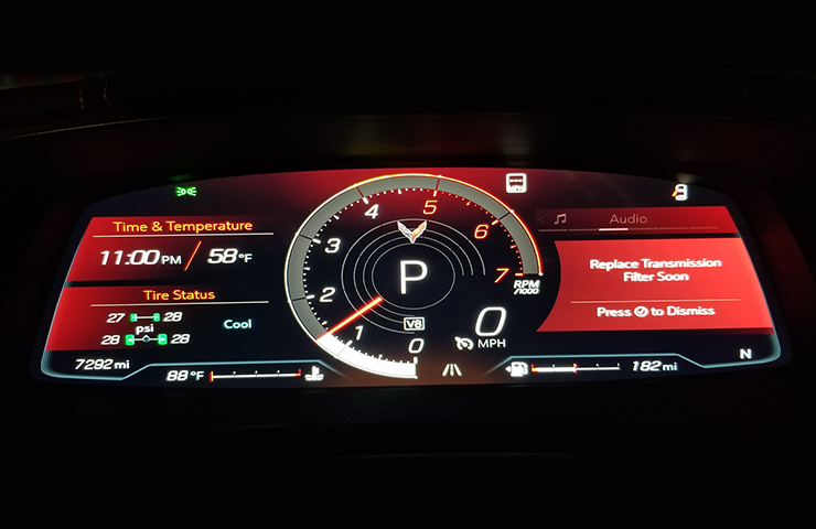

Beginning with the 2023 model year, the Corvette has a maintenance minder on the Driver Information Center that will display a maintenance message shortly before the 7,500-mile (12,000-km) maintenance interval. (Fig. 8) The message also will appear every 22,500 miles (36,000 km). The transmission filter minder cannot be reset like the engine oil life monitor.

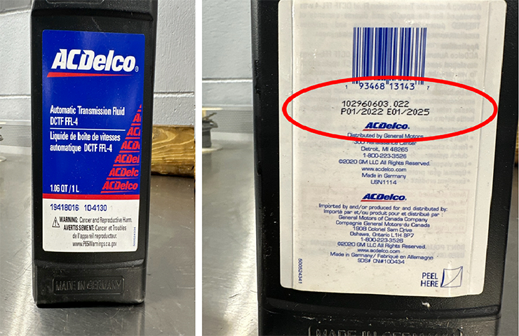

The DCTF FFL-4 C8 Corvette transmission fluid should always be shaken vigorously prior to adding fluid to a vehicle in order to disperse the additives throughout the fluid. The fluid has a shelf life in the sealed bottle of three years. (Fig. 9)
