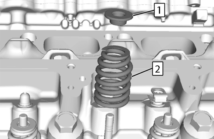

5.3L and 6.6L Engines
On 5.3L and 6.6L engines (RPOs L82, L84 and L8T) built from June 1, 2020 to October 7, 2020, if cylinder leakage is not observed, replace only the affected valve spring. (Fig. 13)
6.2L Engines
On 6.2L engines (RPOs L87, LT1, LT4 and LT2) built from June 1, 2020 to October 7, 2020, if cylinder leakage is not observed, replace all valve springs on both cylinder banks.
2020 Corvette: GM TechLink: Misfire and Engine Noise Condition
Fig. 13
If there is cylinder leakage in the engine, perform further diagnosis to determine the extent of the engine damage and the correct repairs required.
