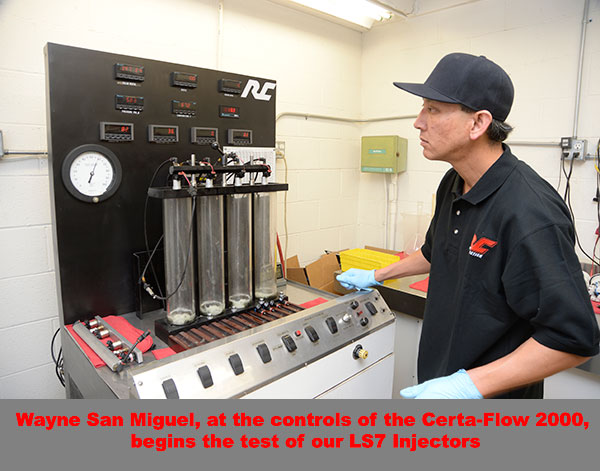

Wanting to cover all bases, I decided to pull the injectors for testing. On my next trip into the greater L.A. area one Thursday morning, I stopped off at RC Fuel Injection and had them flow tested. Injector Technicians Wayne and Keoki San Miguel (yep, they’re brothers) quickly tested my injectors in RC Fuel Injection’s “Certa-Flow 2000” injector flow test machine. Sure enough the “system balance” was 4.8 which means the highest (419 cc/min at 4 bar fuel pressure) and lowest (411.4 cc/min) flowing injectors differed by 4.8%. Ideally, system balance should be 1 to 1.5. A near 5% difference may not make a noticeable difference with a stock engine. but with one where you’re calibrating for exactly .86-lambda at wide-open-throttle, you’re going to see that difference, especially in a case like mine where my Innovate Motorsports wideband O2 sensor is only on one bank on cylinders. In that case, you want to make sure that the other bank of cylinders is not more lean than the bank your calibrating.

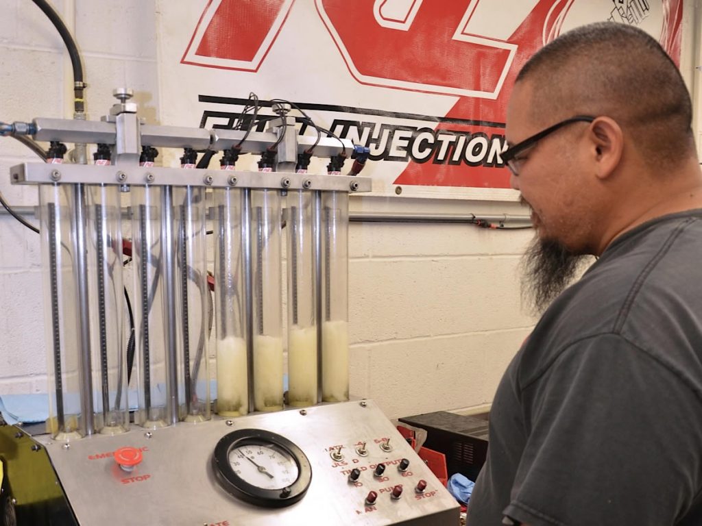

After looking at the flow test data, John Welfringer suggested that I leave the injectors with his guys for a five-hour session in one of RC’s ultra-sonic cleaning machines. Since I was headed back to my shop in Goleta, 150 miles away, he said they’d UPS the injectors to me that evening and I’d have them the next day.
Sure enough, Friday evening, UPS dropped of a box from RC Fuel Injection…love the quick turnaround on testing! Inside were my injectors and a test data print out saying that, once the injectors were cleaned, the system balance (421 cc/min, high, and 416 cc/min, low) was a far better at 1.2. What an improvement! During a road test with HPTuners Data Scanner recording engine controls data the long term fuel trim values were now closer together. It’s a safe assumption that, at wide open throttle, the bank-to-bank A/F was now closer, too.
