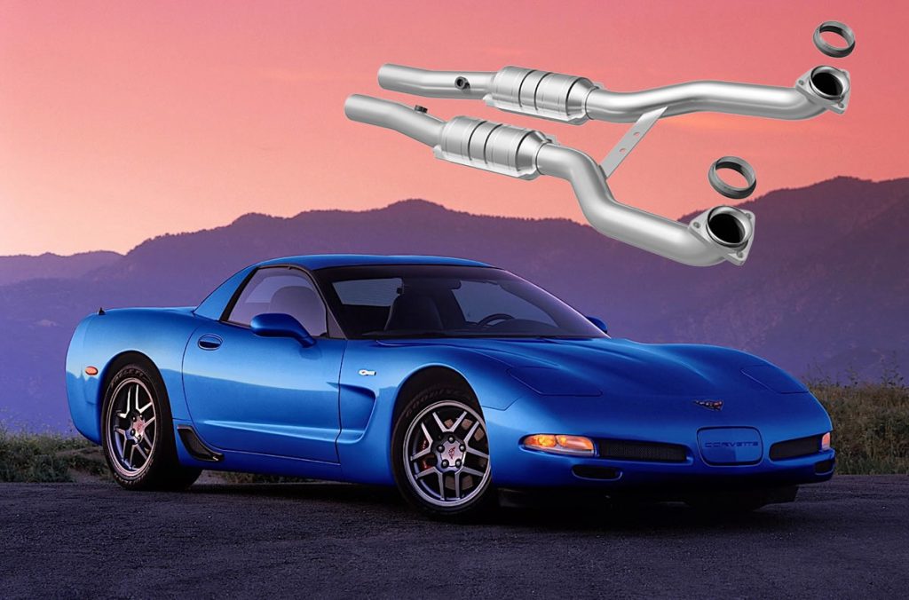

It’s not too often that I get a product which is flat just a bad design, but that’s the case with this MagnaFlow direct fit catalytic converter assembly (PN 448988) for C5 ZO6s.

I lifted the MagnaFlow direct-fit cat set into place, supported it with a jack stand, slid the manifold flange rings in place, then installed the exhaust manifold flange nuts and bolted the cats’ center support to the pad under the rear of the clutch housing. Right away, the installation didn’t look right. I crawled out from under the car and looked at the side view. The two cats were hanging down 3-inches lower than did the stock cats. “WTF?” I wondered.

So, back to looking at the system hanging down 3-inches at the cats and 2 ½ inches at the cat’s rear connection. Ground clearance? Not.
MagnaFlow Direct Fit Catalytic Convertors for C5 Corvette ZO6
I should add that this MagnaFlow cat set is actually not a direct fit because, if you put it on a car with a stock exhaust, you’ll have to cut the last couple feet of the stock exhaust off and weld or clamp it to the rear of the MagnaFlow cats because they’re about two feet short and lack the bolt together muffler connections. Since I had previously cut off the rear of the stock cats and replaced that with the CORSA X-pipe rear section, I’d be ok. Well…except for the fact that the rear connection was 2 ½-inches lower.
If this had been a quarter or half an inch low, I’d would have just gotten out my hydraulic jack and a block of wood and “bent” the system a little to get it up higher, but I wasn’t going to be able to fix such a huge misfit, so I removed MagnaFlow’s so-called “direct fit” set of cats.

Bottom line: If you own a C5 ZO6 registered in California and you’re thinking about buying the Magnaflow 448988 Direct Fit catalytic converter assembly, DON’T DO IT. The part will not fit.
