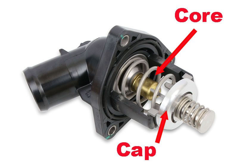

On a C7, regardless of which engine is in the car, LT1, LT4 or LT5, a thermostat change is pretty easy. You drain the radiator–in the case of the ZR1, drain just the main radiator. Remove the duct–properly termed the “upper air baffle extension”–that runs from the back of the radiator to the hood vent. Disconnect the upper radiator hose and the steam hose that runs between the thermostat housing and a tee in the surge-tank-to-radiator pipe. Then remove the three housing bolts and pull out the ‘stat.
The housing and the thermostat assembly are all one piece. The thermostat “core” is part of this assembly. Grasp the housing in one hand and then push the other end of the assembly against spring pressure and twist the bottom metal cap. The cap will come off. The springs will come out. Then, the thermostat core can be extracted from the housing.
Weapon-X 180° Thermostat for 2019 Corvette ZR1
Install the Weapon-X 180 in place of the OE thermostat. Put the big spring pack in place. Then push, twist and lock the bottom cap in place. Put the thermostat assembly back in the front of the engine, install and hand tighten the three housing bolts. Torque each bolt to 10-Newton-Meters or 89-inch-pounds. Finally, reconnect hoses, reinstall clamps and screw the baffle extension back in place.
