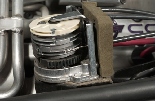

The "Adjuster Assembly" or "Throttle Relaxer" is a motor-operated spindle around which the throttle cables are wound. When the EBTCM commands throttle close-down to reduce rear wheel torque, the Adjuster pulls the cable to decrease the throttle opening.
Image:  Author

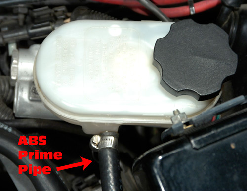

'92-'94 base models and '92-'95 ZR-1s have this master cylinder with a "prime pipe hose" connected to the reservoir. When traction control is active and rear brake intervention is commanded, brake fluid is supplied to the BPM through this hose.
Image:  Author
A new piece of equipment, called either a "throttle relaxer" or an "adjuster assembly," was added under the hood to enable the EBTCM to control the engine's throttle body via additional throttle cables. When TCS applies the rear brakes, it needs a supply of brake fluid, so '92-94 base/'95 ZR-1 systems have a "prime pipe" which brings fluid into the BPM from the master brake cylinder. The '95 base-'96 system uses a "prime valve" inside the BPM to supply fluid. TCS detects positive slip at the rear wheels using the same wheel sensors as ABS, along with engine rpm information. If the rear wheels start to spin up, it has a three-step strategy. First, the EBTCM commands the ECM to retard spark but, at no time, will the spark come later than top-dead-center. While spark retard was implemented for MY92, the '93-'95 ZR-1s had that function disabled.
If spark retard doesn't control slip, the EBTCM reduces throttle opening. If the wheel spin still is not controlled and vehicle speed is below 50 mph, the EBTCM will turn on the BPM's pump to apply the rear brakes. It can do that with a differential basis, if necessary, when the system detects a yaw component in combination with wheelspin.

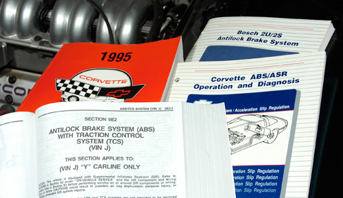

ABS/TCS diagnosis and service requires good service data. At minimum, you need the FSM and, if you find any of the old GM training publications, buy them.
Image:  Author.
First, you need service data. No aftermarket repair manual available to consumers covers ABS/TCS adequately. You need a GM Service Manual for the model year of your Corvette and, if it's an '87, '88, '90 or '91, you, also, need the Section 8A Supplement which contains part of the ABS troubleshooting data. They're available from Corvette Central. Also of value are two GM training publications Bosch 2U/2S Antilock Brake System (PN 15005.0B-4) and Corvette ABS/ASR Operation and Diagnosis (PN 13003.02-1). Both are out-of-print but might turn-up on eBay Motors or at swap meets. If you see them; bid on or buy them.

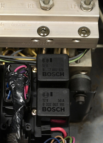

These are ABS relays. Shown is 1995, but '86-'89 is generally similar except that there are three relays (2 located here and a third, the module relay, elsewhere in the well) rather than two.
Image:  Author

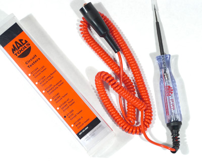

For diagnosis and service of the ABS-2 system and, to a lesser extent, in service of the -2S and -5 systems, you may need a good 12-volt continuity tester or test light. Shown is the Mac Tools model ET-125D, one of the best on the market and what's in our tool box.
Image:  Author.

If you replace the pump motor relay and the system still fails during the dynamic self test, check the solenoid relay which is on the BPM, next to the pump relay. The instructions for testing it are in Service Manual, Sec. 8A, Cell 44, Table C. If the solenoid relay is ok or is replaced but the dynamic self-test still fails, using a DMM, check the resistance of the BPM solenoids as discussed in Sec. 8A, Cell 44, Table B. If resistances are anything other than specified, replace the BPM as discussed in Sec. 5E of the Service Manual.

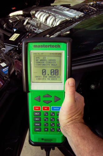

The Bosch Mastertech scan tester reading the memory of a 1995 EBTCM. Code 23 is set. That's a wheel sensor fault we simulated by disconnecting the right front sensor.
Image:  Author

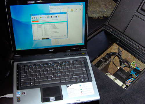

EASE is a heck of a good value if you already have a notebook PC capable of running Windows 98 or better. We use an ACER running XP Home. For this image we simulated some DTCs by disconnecting some wheel sensors. Also, note the NAPA reman controller installed for testing.
Image:  Author
"PC Scan Tool", is a software-based scan tester published by EASE Diagnostics which runs on a personal computer and supports '90-'96 ABS. We evaluated PC Scan Tool on an Acer 5672 notebook PC running Windows XP Home and found it outstanding software for C4 ABS/TCS diagnosis. EASE PC Scan Tool is a great value if you already own a laptop and want a full suite of Corvette diagnostic software which supports not only ABS/ASR but also the engine and body computers. One big advantage PC Scan Tool has over a hardware device like the Mastertech is the ability to display a lot more data parameters at one time.

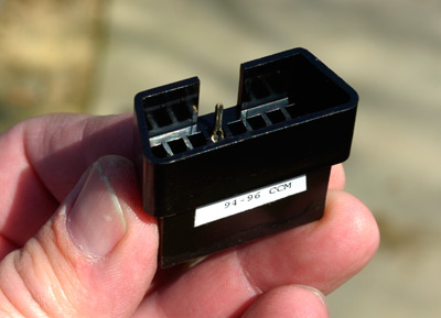

Use CCM (Central Control Module) diagnostics if you're working on a '92-'96 and lack a tester. To put the CCM in diagnostic mode, with a '92 or '93 having a 12-pin DLC, jump pin-G to pin-A or a chassis ground or, on '94-'96 16-pin DLCs, jump pin-12 to pin-4, pin-5 or a chassis ground, then key-up. The IP display will show fault codes and the module in which they are stored. ABS/TCS is module nine. DTCs show on the instrument panel display where vehicle speed is normally seen. An extensive discussion of CCM diagnostics is in the Service Manual for the model year in question.

This is one of Zip Products' grounding plugs. This particular unit enables CCM diagnostics on a '94-'96, but the set of plugs includes a similar unit for ABS. Using these tools is easier than fumbling with jumper wires.
Image:  Author
To make flash-code and CCM diagnostics work, you've got to jumper across DLC pins. In most C4s, it's tough to see the diagnostic connector well enough to count pins. Zip Products has the solution: grounding plugs which snap onto the DLC. We've used a set of these plugs '94-'96 (PN TL-163) and they are a great idea. You simply push one on the DLC, then key-up-way easier than fussing with jumper wires. A set of them (PN TL-162) is, also, available for '86-'93, 12-pin DLCs.

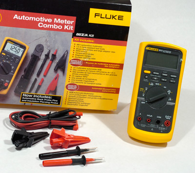

Our favorite DMM, the Fluke 88V. Obviously, we like the Fluke's accuracy and durability but another neat thing is its user-friendliness. For example: need to change probes? Just pull off one set and push on another. Or, mix and match probe ends.
Image:  Author

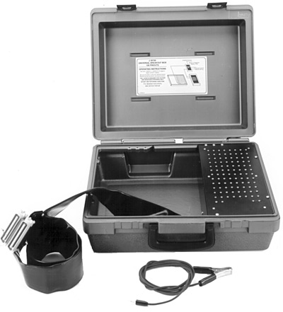

This is the breakout box for MY90-'96 applications. Also required is one of two adapters. Both are available from Kent-Moore.
Image:  SPX Kent-Moore.
Other special tools some DTC solutions may require are: for '86-'89, the "Pinout Box" (PN J-35592) or, for '90-'96, the "Breakout Box" (PN J-39700). Each connects between the controller and the wiring harness to allow easy testing of circuits, some of which may need to be energized during testing. The later box, also, requires an adapter and there are two: J 39700-10 for '92-'94 base/'95 ZR-1 and J39700-15 for '95 base/'96. In some situations, you can achieve similar tests by carefully connecting the DMM to harness connector pins, however, in other situations, you cannot perform the required test without the breakout box and, in any event, the box is always easier to work with. When your diagnosis leads you to these tools, take the car to a service facility which has one or, if you're a well-heeled DIY wanting either of these tools, order them from SPX Kent-Moore, the supplier of GM service tools.

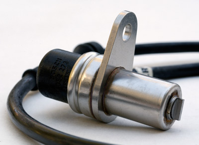

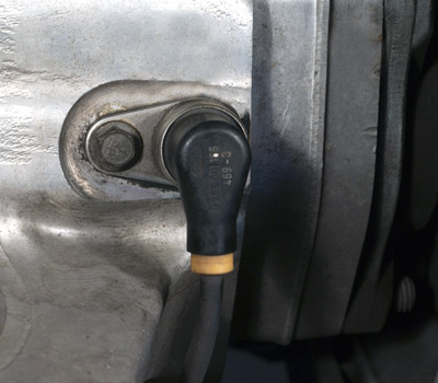

David Fulcher told us, "In the rear, the exposed sensors tend to accumulate metal filings from the rear brakes. After a while that can start to knock out the signal. The early ('86-'89) front units had a problem with tips breaking off if you hit a curb or similar object. That is one of the reasons I believe that GM moved the sensor into the hub assembly." Early style front wheel sensors and all rear sensors are inserted into holes in the suspension knuckles. If you're directed to replace a sensor, you may find it "frozen" due to galvanic corrosion which was a problem with early, metal-bodied sensors. The prescribed method of removal is to first, apply a good penetrant, such as "Sili-Kroil", available from the Eastwood Company, let it sit several hours, then apply a modest amount of heat to the surrounding structure using a propane torch or similar device. Start by rotating the sensor to loosen it and eventually it will come out. The heat usually ruins the sensor but if it's bad to begin with, so what.
click for larger view click for larger view
Click image for larger view
The installed view of a sensor. To extract it, you remove the bolt then withdraw the sensor. It's seldom that easy if dirt and corrosion works between the sensor body and the knuckle.
Image:  Author

This is the business end of a rear wheel sensor and the part that sometimes seizes in the rear suspension knuckle.
Image:  Author.
