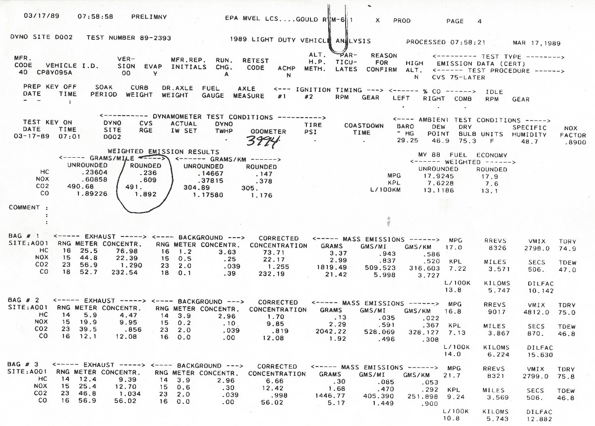

As manufacturer's representatives, we weren't allowed anywhere near the car on test but somehow, I know that the young lady who came out to drive the car was a Corvette nut. She had kicked off her sneakers to drive the test in bare feet and I offered up a silent prayer of thanks! We got the result – the car had passed emissions but the fuel economy was off. Depending on how the numbers were rounded and processed we had avoided gas guzzler or not. Of course, EPA said not! Aw s**t!! The wheels were coming off! This kind of experience is 'character building!'
Looking at the numbers, the progression of fuel economy through the three parts of the cold FTP was wrong. The middle phase was never lower than the first. Our middle phase was less than the first. That suggested a major screw up, but the emissions were sound and the car had driven perfectly the driver's report said. It seemed to me that the only thing that could explain this was that my favorite driver in the whole world had shifted out of 4th in the long low speed cruise (cycle 11 for the sad amongst us) and gone straight forward into 3rd not 5th. The next hurdle was that I was 99% sure that I knew what had gone wrong but we could do nothing until we heard the result through the proper channels and thus make a request that EPA consider our argument.

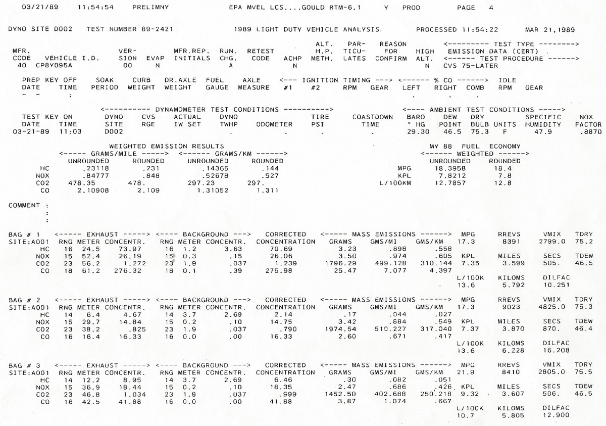

A new test date was scheduled for the 21st and I drove the Ann Arbor alone this time in P8Y094. (I wonder why that was?) 'Big Jim' came out to drive the car, he really was substantial guy and my heart sank! But - he drove the most perfect test that I'd ever seen. The numbers were crunched and we'd avoided gas guzzler by 0.03 mpg (US).

Here are the two EPA FTP75 emission test results from P8Y095 in March '89 and a copy of the 'Certificate' - The piece of paper that it was all about.
EPA FTP75 emission test results from P8Y095 in March 21 1989
