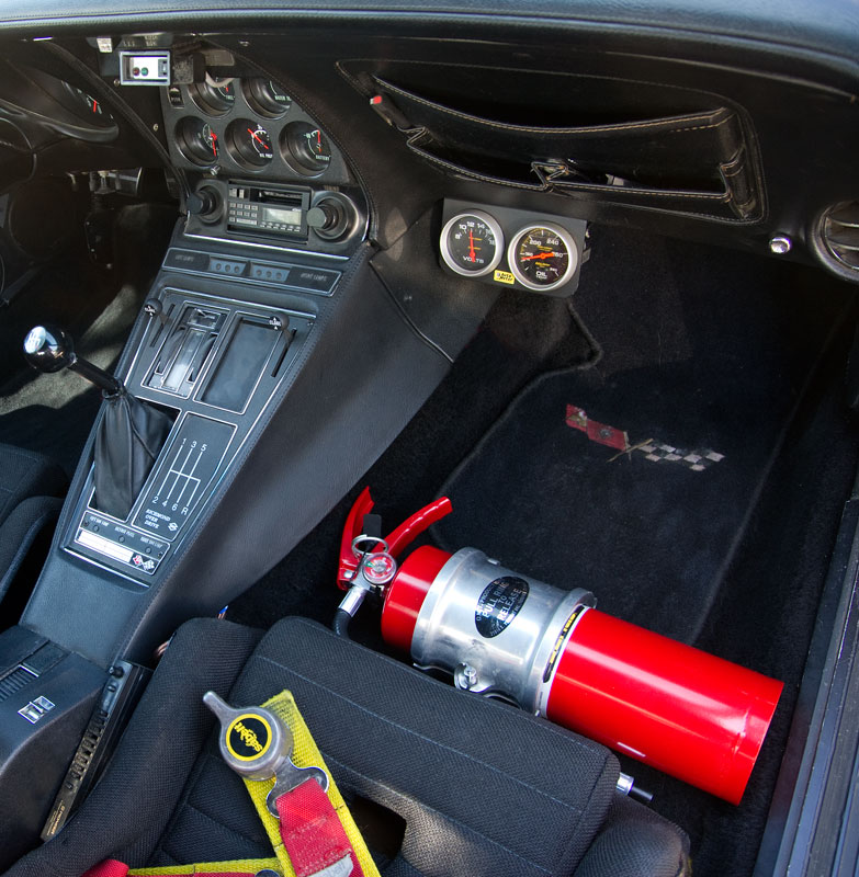

The owner of this 71 Corvette used the biggest Ansul extinguisher, a Sentry A05, rated 3-A:10-B:C (PN 429001), he could fit in the available space and mounted it in a custom-built aluminum bracket. With the narrow footwells in a C3, you can't mount the extinguisher on the tunnel. In this case, it fits under the passengers legs, just ahead of the passenger seat.
A fire extinguisher needs to be mounted securely and safely in the vehicle. Many units designed for carrying in a car come with some type of mounting bracket or cradle. If your extinguisher does come with a mount, we strongly suggest using it because the unit's maker has designed the mount specifically for that extinguisher. Locate the extinguisher in a place were it can be easily reached, but does not pose a hazard in a collision. One place you absolutely do not want to mount a fire extinguisher is on the windshield post inside the car. In a frontal impact your head or your passenger's head could hit the fire extinguisher resulting in severe head injury or death.

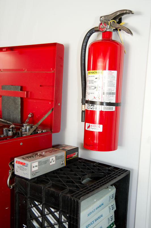

For your garage or shop, have at least a 3-A:40-B:C-rated unit or, better yet, a 4-A:60- or 80-B:C, filled with ABC dry chem. Again, if your workshop activity involves a lot of metal finishing work on aluminum parts, consider a Class-D extinguisher.
Click for larger view
Image:  Author.
This Kidde ProPlus 10MP 4-A:80-B:C extinguisher (PN468002) is mounted on the wall in a two-car garage. For extinguishers hanging on walls, fire safety experts say the mount or hanger should be installed such that the top of the extinguisher is between 3.5- and 5-feet above the floor.
