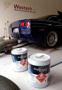

Our dyno test showed the best gasoline choice for a computer-controlled car that sees a little detonation on hot days is a mix of racing gasoline and pump gasoline. Image: Author
In areas which are below 3000 feet altitude, on cool days and on 93-octane fuel, there's no problem, but in warm weather, or in just about any weather when running 91-octane, the engine will get a little detonation, the knock sensing will retard spark and performance will drop slightly. A small amount of unleaded race gas mixed with premium pump gas is the best way to eliminate this problem, short of engine modifications, changes in calibration, moving to a cooler area or moving to the mid-west or eastern seaboard where 93-94-octane gas is widely sold. We suggest starting at 1:5, pump gas to 100 unleaded, then work up until the detonation or knock retard goes away.
Does this work in practice? We took our C5 Z to the AutoDyn at Westech, ran some baseline tests and observed knock retard with the Mastertech. Back at our shop, we drained the fuel tanks, added 10 gallons of Rockett Brand 100 then drove 50 miles back to Westech. This time, the IAT was 106°, the engine ran with no knock retard and the dyno read 9.5hp more than the first test on straight premium unleaded. After lunch, we "thinned" the remaining Rockett 100 down to 94.6-oct. by mixing it 2:3 with Chevron 91-oct. and ran again. The IAT was now 109 and the power was up 7.5-hp over straight pump gas. In all runs of this second round of tests, our Vetronix Mastertech showed no detonation. Clearly, in hot weather, unleaded racing gas works well as a detonation fighter.
