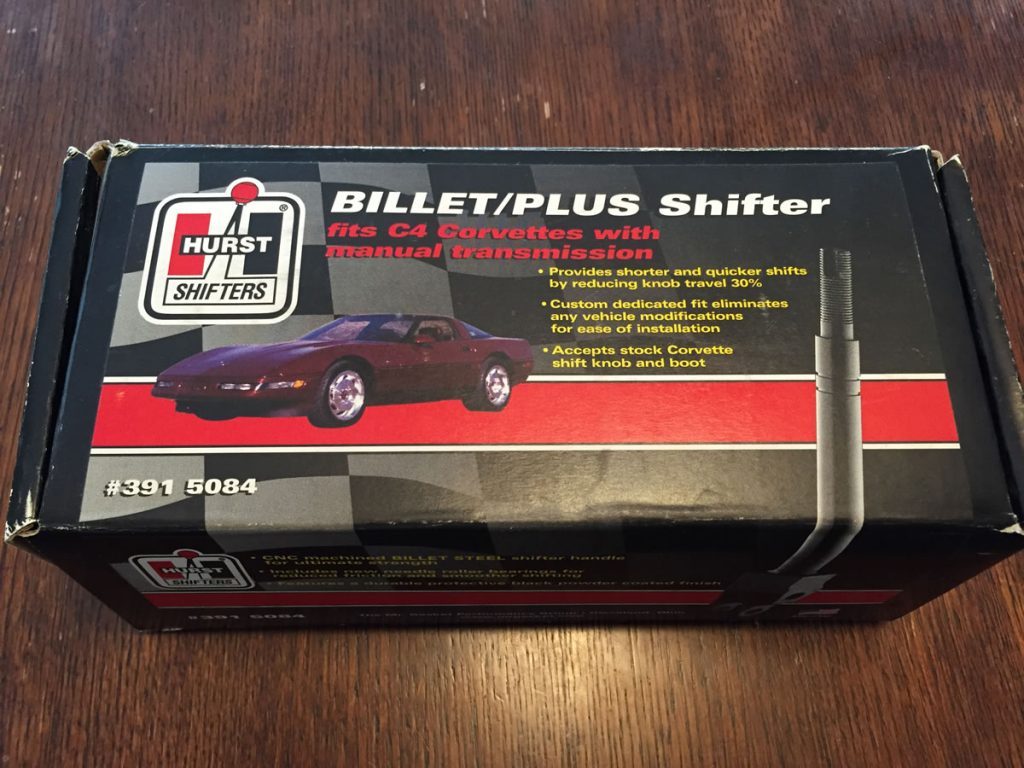

The Hurst package is pretty simple: a replacement shift lever, shims for setting the end-play, cable ties for the lower shift boot and instructions. Image: Author.
For those working on their own cars, the Hurst people include a very good set of instructions with the Billet/Plus Shifter. The job takes DIYs with intermediate mechanical skills and common hand tools, a floor jack and jack stands about three hours.
